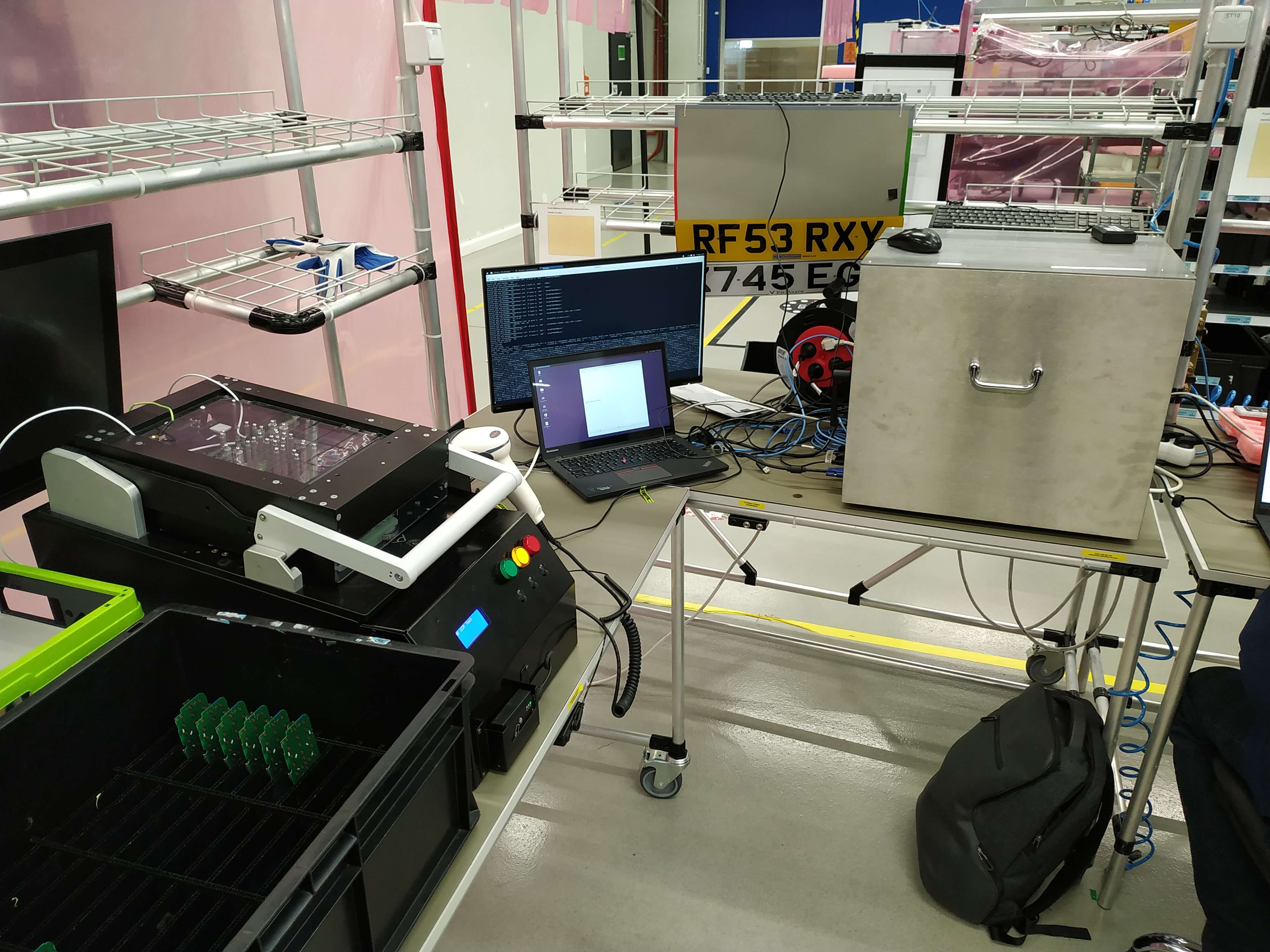

This photo features some of the machines we use to test our phone. On the left you can see our phone's motherboard tester, which is used to check the MB (Main Board) before mounting it in the phone. The boards are in the box next to it, waiting for testing.  The silver device is the End of Line tester. It is used to check the whole device after assembly (test of screen, backlight and keyboard, speakers, microphone, cellular module, flashlight, audio jack).

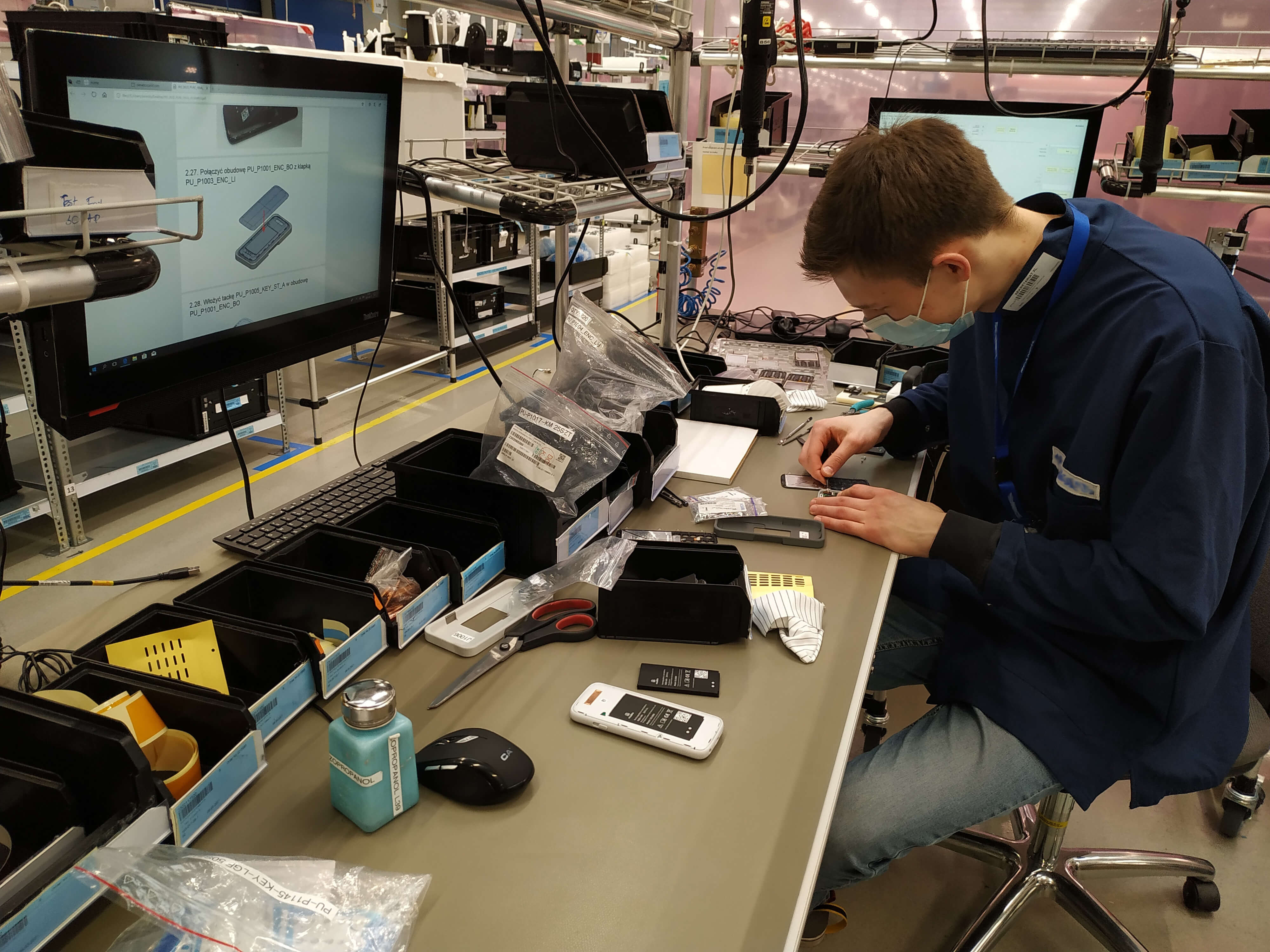

Photo shows a section of the assembly line, where our team member, Radosalaw, is checking that the assembly process  is consistent with what we have prepared in the assembly manual.

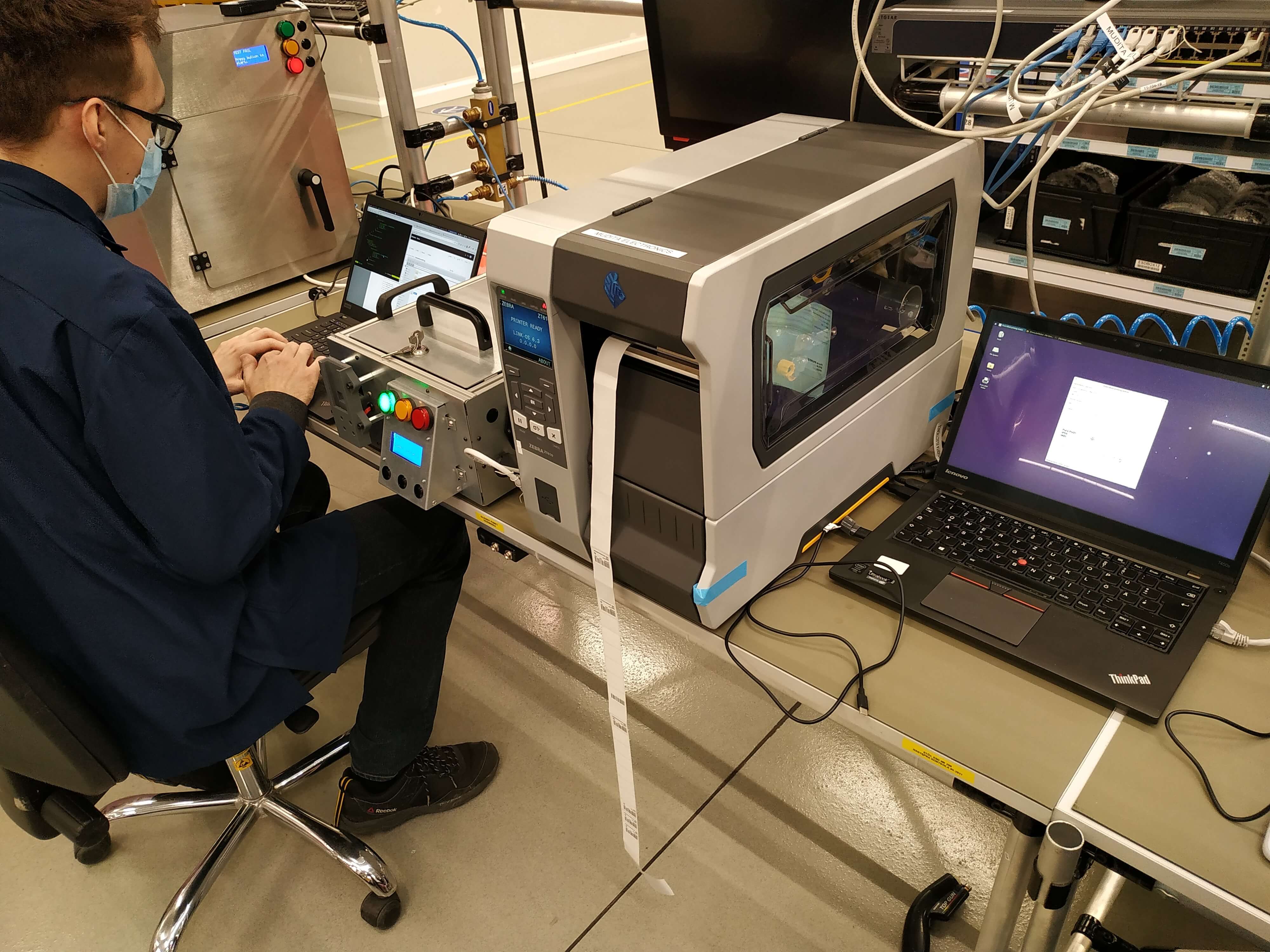

Our engineering team member, Andrzej is using a laptop which operates an industrial printer for labels (applied inside the battery compartment). Next to him is an EOL (End of Line) tester, which is used to check the whole device after assembly (test of screen, backlight and keyboard, speakers, microphone, cellular module, flashlight, audio jack).

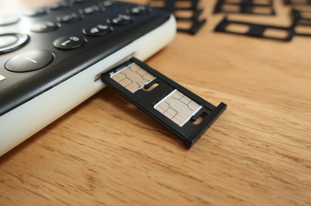

We have made improvements to the SIM tray, adding support for the SIM cards, which prevents them from moving or falling out when being changed or handled.
Improved SIM card tray
