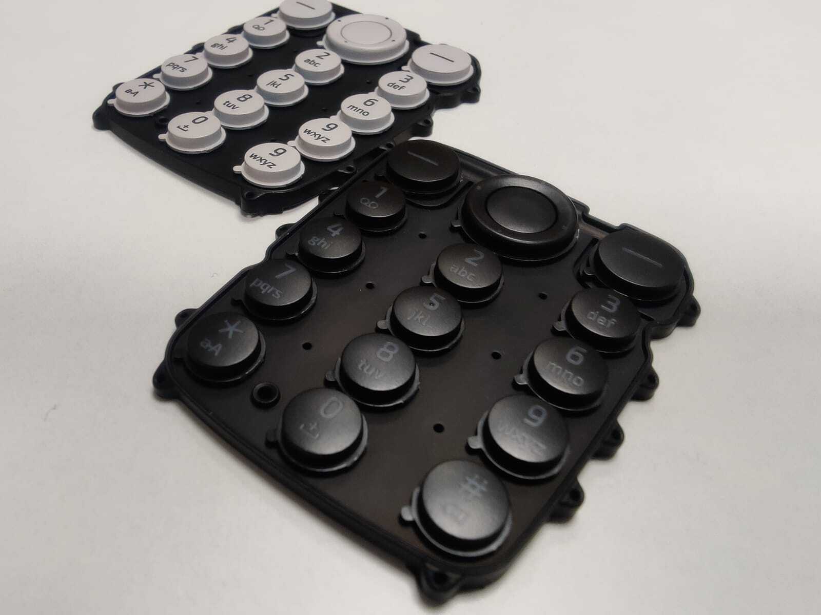

The keyboards underwent another iteration, which improved the separation of the backlight from overflowing into the function keys.  Additional material was added at the base of the function and number keys, isolating the light, and preventing light overflow.
The pictures below show how the light of the numerical and function keys is isolated.
Backlit keypad of a Mudita Pure in the dark
This photo shows the final look of the keyboard backlight.
Mudita Pure keyboards
This is the final version of the keyboards for both Mudita Pure Pebble Gray and Charcoal Black.
Pure keyboard back light
These two pictures present Function keys. They show the function keys being lit. On the left, you can see the overflow of light in the previous version of the keyboard. Right version contains light blockers.

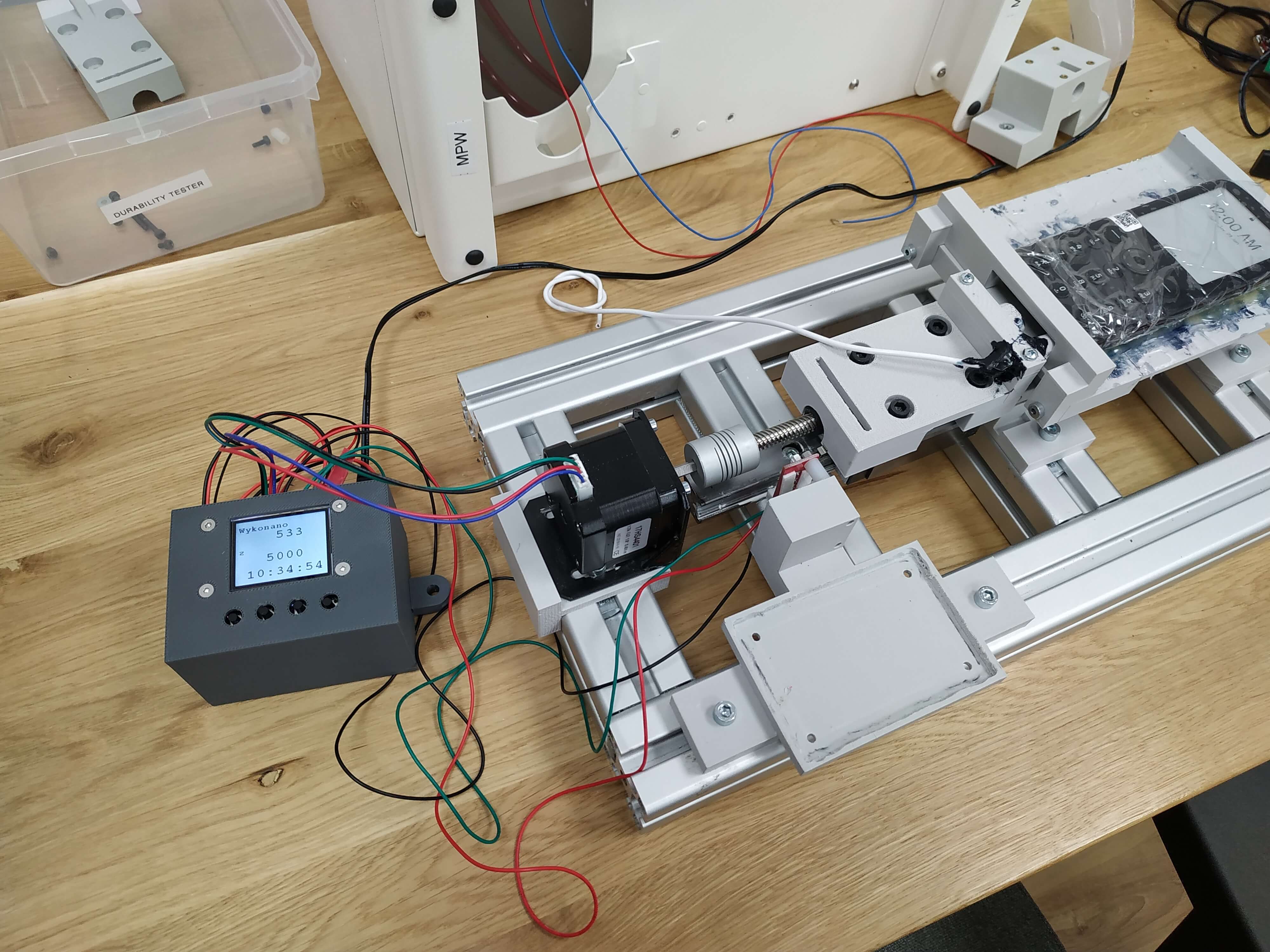

Audio jack strength tests
For the new batch of PCB_LM, audio jack strength tests (automatic plug-in and plug-out) were performed.
We noticed that damage occurred after 7,000 cycles, -more specifically, breakage of copper in the board, which caused the audio jack and loudspeaker to stop functioning properly. The solution which we want to apply for that is that right now, a new version of MDT (Mechanical Durability Tester) was prepared, where the display and buttons for setting the parameters and displaying test progress were added. Thus, we will repeat the tests and check all the parameters to confirm that the damage does not repeat. We will do this once we have more samples of Mudita Pure. To resolve the problem, we will shorten the PCB_LM at least prototypically to get rid of the bend that results in this crack (because the audio jack moves a little bit every time you insert the plug).
If this does not resolve the problem, we have another PCB supplier, whose samples could withstand >10k cycles (on older prototypes).
Measurement unit with a display, wired up on a workbench
Test rig wired up on a workbench during hardware development
Close-up of a test rig used in Mudita hardware development
These three pictures show Mechanical Durability Tester during the test of Audio Jack.

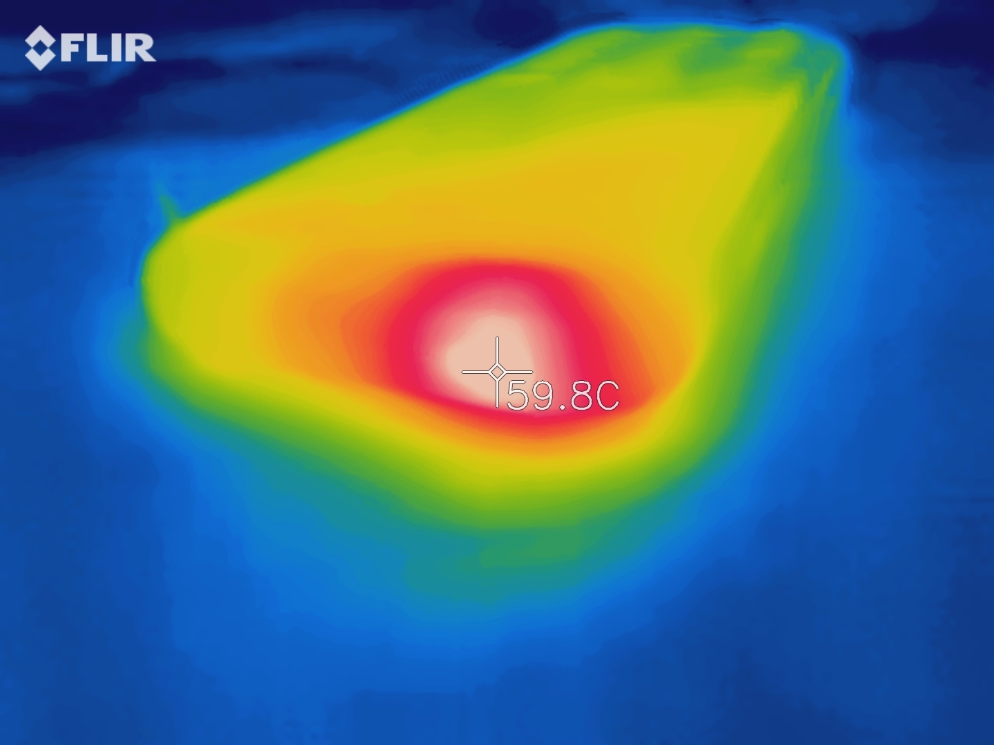

The temperature of the flashlight lens (from the outside) and the temperature of the PCB (Printed Circuit Board) have been measured. The purpose of the measurement is to check whether the obtained temperature is within the required limits (material, regulatory, etc.).
The final maximum power of the flashlight will be selected upon further tests and determination of the lens material. Below are pictures taken with a thermal imaging camera.
Thermal image of a component reaching 39.8 degrees Celsius
Thermal image of a Mudita phone peaking at 31.4 degrees Celsius

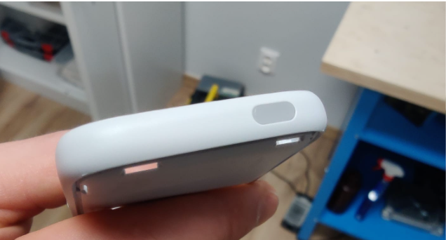

We also tested the flashlight with the dispersion material. The scope of the test was to compare the Mudita Pure flashlight version (1) of PMMA without diffusion bonding and version (2) of PC with 1 : 4 = 25% diffusion bonding. For the tests purposes we used materials from two different manufacturers.
In the photos below you can clearly see the difference between new and old lenses with old and new dispersion material.
Hand holding a white Mudita phone prototype from the side
PC flashlight + 1:4 diffusion material - gray casing.
Hand holding a black Mudita phone prototype
PC flashlight + 1:4 diffusion material - black casing.
Side button on a black Mudita phone prototype held in a hand
PMMA flashlight in old material.
In the photos below, is the comparison of the distance of 0.5m of flashlight from the wall taken with a photo camera with lens 18mm ISO 200 F4 1".
Comparison of the old and new backlight lens at white and yellow diode settings
The conclusions of these tests are as follows:
The diffusion material has positively influenced the light scattering of the flashlight. The light is scattered evenly. On the other hand, a loss of luminous power was observed, therefore a test on a smaller content of diffusion material must be done.

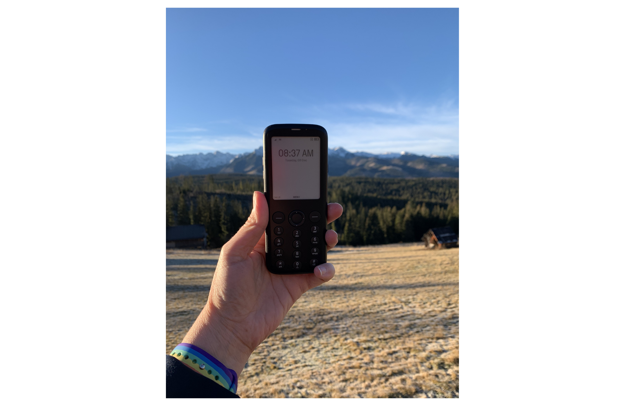

Joanna - PR Manager - conducted her test in the beauty of Polish mountains. It was a crucial test, as the GSM range is quite weak there on a daily basis in every kind of mobile phone. Look what she said after her test:
"The Polish Tatra Mountains are my natural habitat. I have lived here for many years and I always come back with joy. Anyway, who doesn't love the mountains, right? This time my trip to the mountains had a very important aspect. Our antenna has been well tested in flat terrain where it has performed perfectly. Despite the low emission value, the range was very good at all frequencies. This time we wanted to test the phone in difficult conditions. Not only weather conditions, at very low temperatures, but also extremely mountainous terrain. In the Polish Tatras, very often the best smartphones can lose range. I have to admit that I had various fears: will I lose the range, or if the battery will last and allow me to stay connected during the mountain hike, and how the phone will behave in low temperatures. After many days of testing the device, I can confidently say that Mudita Pure is an invaluable companion for mountain hiking. Whether it was 900 m or 1300 m above sea level, Mudita Pure did not lose its range.  Very severe frosts are predicted in the coming days (forecasted temperatures below -15 Celsius degrees ), and I’m excited because more Mudita Pure tests are ahead of us.“
Hand holding a Mudita Pure against a mountain landscape
