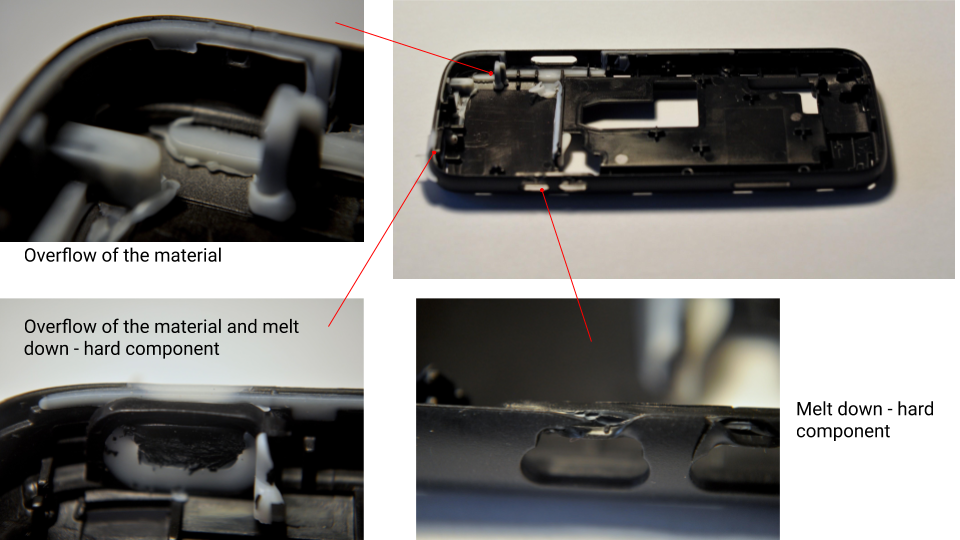

Unfortunately the production process sometimes brings unpleasant surprises which are outside of our control. Last week, we came across an issue which has forced us to revise our production calendar. The latest tests with the molding form for the body part revealed a serious problem, which we need to fix before starting the mass production.
The problem
We continue to work on the most complex part of Mudita Pure casing - the body. At the factory, which is building this molding form, we’ve run the trials of injecting the rubber part, which seals up the front housing and rear cover. We found a critical technical problem here: the material doesn’t flow as planned. There is an overflow which causes the material to go beyond the designed shape and does not fill the whole surface as planned - thus it doesn’t work as a seal. Additionally, the heated material melts the hard component next to it.
It seemed like a minor problem at first. However, after discussing it with our partners and experts, this turns out to be much more serious and there’s no easy solution to fix this quickly. Correcting this molding form requires additional work, and unfortunately, time.
The material overflow
Overflow - view from the outside
The solution
Together with our partner, responsible for constructing this injection molding form, we’ve come up with the solution and prepared the plan for correcting this flaw. We created the models showing how the form will change, in order to assure the correct flow of the material.
The whole rubber element needs to be thicker, the radiuses in corners are smoother, additional rubber channels were added to reduce pressure during the injection process. This will cause a temperature drop of injected rubber and eliminate plastic melt.
Current 3D model with rubber flow problem
Rubber after 5 iterations of moldflow simulations
Illustrations above show the changes of the casing part.  Now, the manufacturer of the molding form will need to redesign the injection molding form and repeat the process in order to fix the problem. The most complex procedure, with 7 additional trials, means we will see the end result in April. However, we hope to solve this problem faster.
