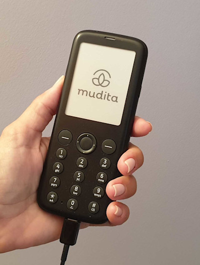

We have an amazingly talented team who is currently testing Mudita Pure. Apart from these latest complications, the prototypes are fully functional and we can already experience using our phones in everyday life. We’ve had great progress in terms of the operating system and Mudita Center - we would like to share with you the current state of the development.
Video 1: Going through Mudita Pure menu and different functionalities. Please note that the screens reflect the current status of the development, as we're constantly improving the OS and the UI based on the tests and feedback.
